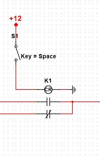

i'using a relay on my project in Multisim but there's no case or footprint  so i can't tranfer to uitllboard and place to pcb? What can i use it? There a solution fot that?

Here's an NI article showing how to assign a footprint to your virtual component.
https://knowledge.ni.com/KnowledgeArticleDetails?id=kA00Z000000P8jUSAS&l=en-US
