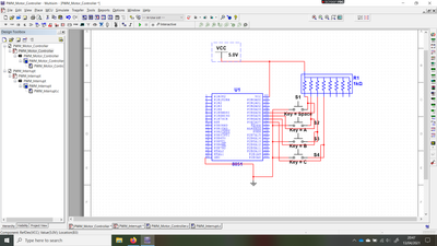

Hi all, can anyone help?
I'm trying to run a simple PWM circuit (4 button, 40%/60%/100%/stop) and I'm getting a strange error. The code was ripped off from https://www.electronicshub.org/pwm-based-dc-motor-speed-control-using-microcontroller/ and I've adapted it for 8051 Hitech C compiler. The code follows along with the 12 linking errors.
Thanks in advance.

Multisim - 13 April 2021, 20:35:50
--------------------Building: Project: PWM_Motor_Controller---------------------
Note: -E compiler option was not present. This option has been added to the compiler build command temporarily.
Note: -O compiler option was not present. This option has been added to the compiler build command temporarily.
Compiler results: 0 - Errors, 0 - Warnings
Linking...
Error: : 0 fixup overflow referencing psect data (location 0x1D (0x3+26), size 1, value 0x100)
Error: : 0 fixup overflow referencing psect data (location 0x2C (0x3+41), size 1, value 0x100)
Error: : 0 fixup overflow referencing psect data (location 0x3B (0x3+56), size 1, value 0x100)
Error: : 0 fixup overflow referencing psect data (location 0x47 (0x3+68), size 1, value 0x100)
Error: : 0 fixup overflow referencing psect data (location 0x71 (0x3+110), size 1, value 0x100)
Error: : 0 fixup overflow referencing psect data (location 0x9F (0x3+156), size 1, value 0x100)
Error: : 0 fixup overflow in expression (location 0x23 (0x23+0), size 1, value 0x100)
Linker results: 12 - Errors, 0 - Warnings
Message 1 of 1
