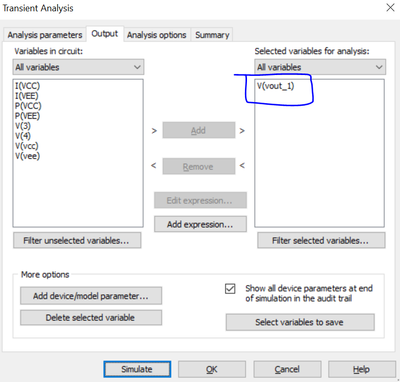

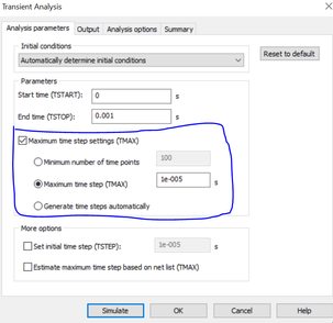

Before I simulate to obtain my graph, I made some settings learnt from YouTube, and I attached my settings as shown below
Then I clicked on "Simulate"
The graph below then appears
