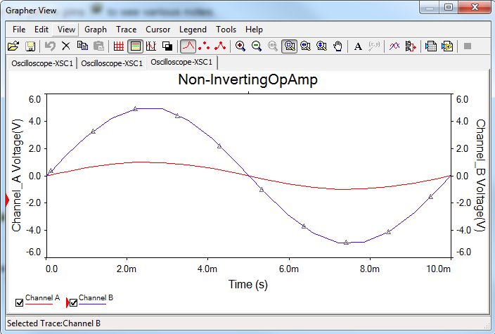

By the way, there is another method to identify the values which is to see the plot in the Grapher View Window.
Click the button on the toolbar and you will see your plot like the one shown below.
Right-click the figure and we can set the Graph Properties. In the Left axis and Bottom axis tabs, we can adjust the ranges to make the figure look nice.
This method can also help you find the values.
