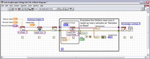

Basically the way you should be approach this specification is by: setting the samples to read to you desired value. This example will help you to accomplish it: Cont Acq&Graph Voltage-Int Clk.vi” and please take a look at the screenshot. With more information I might give you a better answer.
