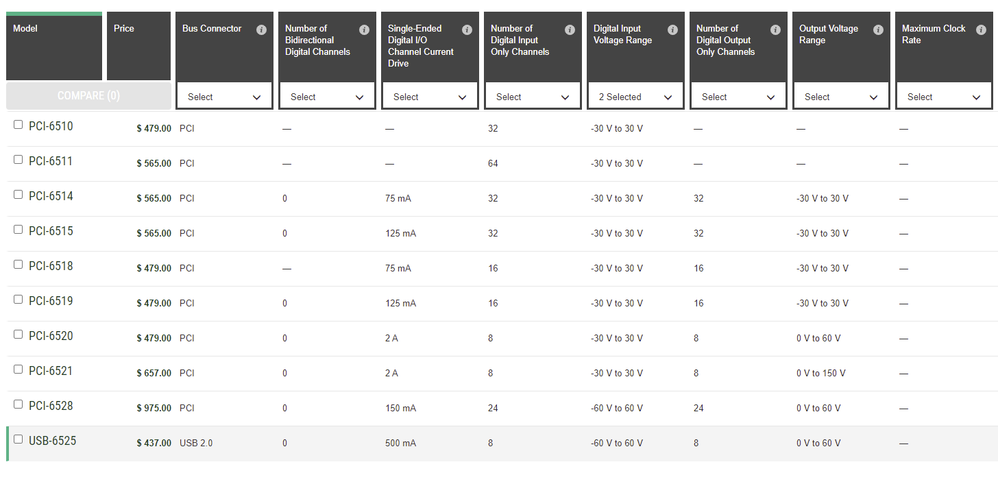

Hello, I am upgrading an old PC witch has an PCI-6518. New PC’s have PCIex instead of PCI.
Does any one know if there is a 1:1 replacement for the PCI-6518?Or at least as close as possible?
(1,150 Views)
Looks like all the industrial Digital IO cards are PCI only. The PCIe/USB variants are typically 5V logic.
https://www.ni.com/en-us/shop/category/digital-io.html?productId=118259
Some options
  1. Find a new PC with PCI slot, definitely available in the market, but not the general consumer segment
  2. Redesign your application, find a new card that may fit your application - not guaranteed to satisfy all your requirements, on the way you might need to compromise
Note: No, NI does not support the use of PCIe to PCI adapters, you may try at your own risk, but any issue you encounter will not have any support.
