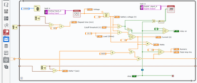

My goal is simple:  Plot a discharge curve for a battery with a load across it, then disconnect the load when the voltage drops below a threshold to prevent damaging the battery.
I can chart a battery voltage using NI USB 6008.  I can turn the relay on and off with a digital output.  But I can't figure out how to compare the voltage data stream (1D waveform?) to a constant to turn off the relay.  There is a data type mismatch that I don't understand.
Should be simple, but I am stumped!

not sure how to upload code...  My problems seem to be related to mismatched data types.  Can't compare a 1D waveform from the DAQ to a constant.  not sure how to trigger the DAQ digital out from a boolean comparison

You should be able to get the y component of the waveform and index out the last element.

was not able to figure out how to get the y component and index to the last element. got it sort of working by changing the DAQmx data format from waveform to "floating Point".  but now, after 1000 while loops, I get this error:
 here is what the code looks like:

Can I suggest you bypass all the data aquisition and programming and just use a trip amplifier?
E.G https://www.pepperl-fuchs.com/global/en/32554.htm
or https://uk.rs-online.com/web/p/signal-conditioners/7966913
This will mean that your battery protection is independant of your computer & software.
