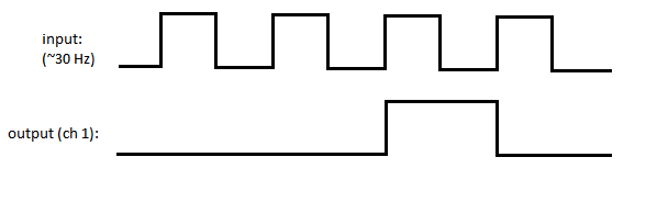

Hello, I have a PCI-6711 DAQ board and I am using VB2008 to control it with Vista x64. I have used the .Net 3.5 examples successfully to count leading edge pulses and I have modified the example so on every third pulse, it sends out a TTL pulse on Output channel #0. What I'd like to do now is to send a output pulse out that is High on the leading edge of the third input pulse counted and send an output pulse out that is Low on the Falling edge of the third input pulse counted.
         I tried to run two Tasks simulaneously, one counting the rising edges and one counting the falling edges. This did not work, I got an error message when I told the second task to Start. I am looking for some suggestions on how to do this. I looked at some of the "measure Pulse width" examples but didn't understand them. The input pulses will be in the range of 60Hz to 1 Hz. and I'd like to run this function for 4 hours or more if that makes any difference.

I'd like to clarify what you're trying to do.  From your earlier statement:
I'd like to copy 3 of 4 pulses but the fourth pulse, I'd like to send out a second output port.
Does the following graph represent what you need?
If so, the best way would be to use a board that supports Clocked digital I/O (I would look into the PCIe 6230 if you have a PCI Express slot available in your PC, if not the PCI 6220 is a good alternative).  There isn't going to be a way to get exactly the above signals using your 6711 (which does not support change detection nor does it support clocked digital I/O--the above solution requires the use of both).
Having said this, you can perform the following on your 6711 using a Counter Output task set to Pulse Mode:
Let us know which one of the above you'd like to go with (or if it's something else entirely) and we can provide more details about how to set up the task.
