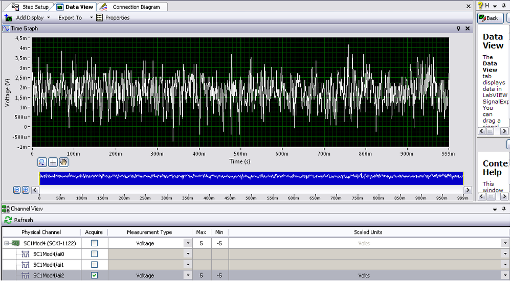

I decided to post voltage readings instead of strain to make things simpler. Also, I found out that Measurement & Automation Explorer does the same thing as MATLAB does. If I run it first, I get incorrect readings. If I run it after SignalExpress, the reading is correct.
Here is the measurement after I turned on the device. I should mention that I was measuring 2.6 mV with a multimeter during this measurement.
Then I ran Measurement & Automation Explorer and heard the click and the readings were correct. After stopping Measurement & Automation Explorer, I ran SignalExpress. Here is the measurement I got:
The same thing happens if I run them in reverse order.
I was using 4 strain gages connected in Full Bridge 1 configuration, since I am measuring voltage it does not matter anymore. Just to make sure I have not missed anything, I also tried with channel 1 and another voltage source. The results were the same. I will update once I try with other channels.
I could not understand what you meant by SignalExpress code. I am quite new to NI software and all I did was to create a new project and select analog voltage input and my channel. I am using only channel 2.

What I meant was the right hand side of your Signal Express Code but the information you posted gave me quite enough information. I will be attempting to recreate the issue by setting up your hardware and seeing if I get the same behavior. I will let you know the results of my test. Also, please let me know if this behavior is occurring using different channels on your device as well.
