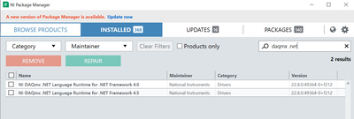

The daqmx.dll and the common.dll are just the libraries with the user API. You need to use the full NI-DAQmx driver installer to install the .NET Runtime package as shown below.
