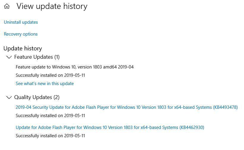

I have got a problem with NIMAX which is not detecting any of the two NI devices connected to the computer anymore. It was working fine until a recent windows update with some seemingly unrelated patches (see figure).
Windows device manager can see both devices, i.e. cDAQ-9178 and NI-6009 (see figure) but they are both reported as "not present" in NIMAX.
We have tried to restart computer and devices, meaning 10 second power cuts, several times. Then used "repair" option of DAQmx driver with no change. Then uninstalled all NI software, restarted and re-installed LabView RTE, VISA and DAQmx again. Then upgrading them through NI update service to the last versions.

Similar issue here yesterday again after updates- 3 systems failed to detect hardware.
In Services, try setting the NI device loader to Automatic Delayed Start and reboot.
It may take a minute or two for the service to start. Then go into Max and deleted 'dead' devices and rename found ones accordingly.
-AK2DM
(6,876 Views)
Thank you for the tip. It worked perfectly. Up and running again. Smiley Very Happy
