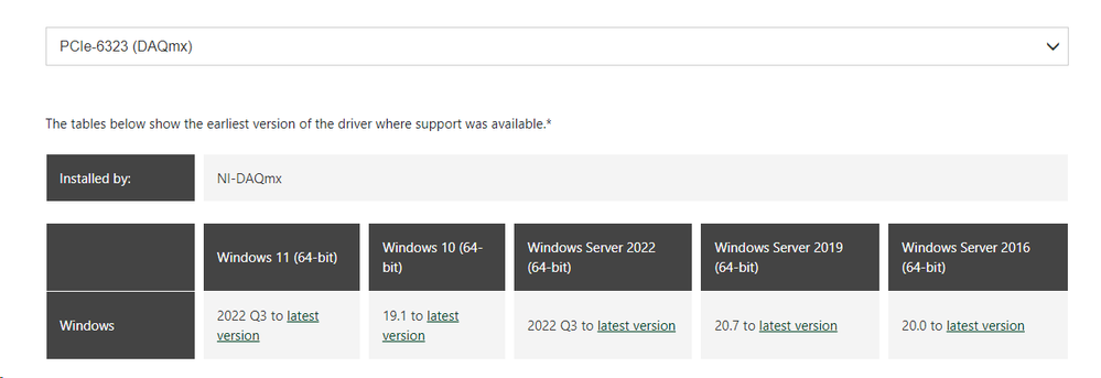

I'm trying to install a NI PCIE-6323 on a Window 11 Pro PC but it is not detected by NI-MAX or the PC.
I have connected a PC disk drive power connector to the device power connector.
I have changed the link state power management of the PCI Express to OFF.
Any suggestions?
Are there compatibility issues with Windows 11?
Thank you

Do you have DAQmx 2022 Q3 or latest installed?

I have the latest DAQmx installed
(3,248 Views)
Try updating the BIOS to the latest version.
Check if there is any card installed in slot 1.

Update:
The card was detected when connecting to a PCiex16.
It could not be detected on a PCiex1
This is on Dell Optiplex 7010
Bios 1.10.0
