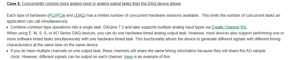

Is there any official document describing "only one DAQmx Task per board per type for hardware-timed operations on AI, AO, DI, and DO"?
It's weird as I was able to use two threads to process two digital lines, as well as two analog outputs at the same time.
(644 Views)
You can use it as long as the hardware timed task is not running simultaneously or you were using software timed single point, i.e., doesn't use a sample clock.
Here you go,
https://knowledge.ni.com/KnowledgeArticleDetails?id=kA00Z0000019KWYSA2
Check out the Hardware-timed section, i.e., if it uses a sample clock.
Another related article, https://knowledge.ni.com/KnowledgeArticleDetails?id=kA00Z000000P8kmSAC&l=en-US
