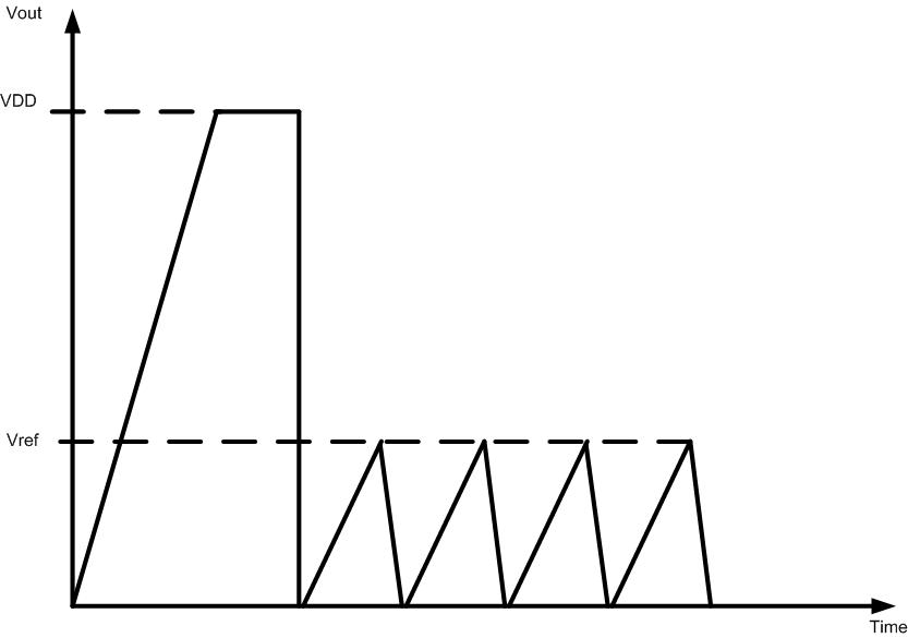

5. It is no problem if we let the integrator rail at the begining as long as the control signal is retriggerable. So if we don't make any change to the code, the output of the integrator can be expected as the picture. Is that correct?
   However, I'm wondering if we can set the counter output to low at the begining of the program. For instance, can I add a sequence before the integrating action. And in this sequence, we set the counter output to low. I'm not sure if this is possible. Even if not, the current code is enough for my application.
