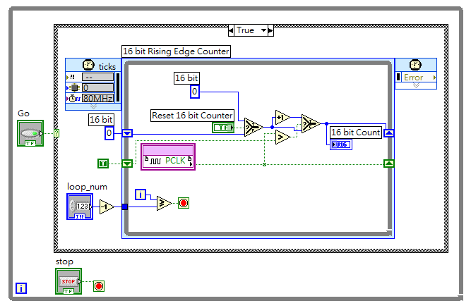

We want to connect the CMOS camera to PCIe-7842R with SCB68 box to analyze image in FPGA. There are PCLK (pixel clock) signal (36 MHz) and 8-bit data.
At 1st, we write a test program to make sure that we can detect the PCLK correct which is attached as program.png. The program is very simple that there is a timed-loop with 80 MHz which should be sufficient to catch 36 MHz signal. If "Numeric 2" set to 8000, we should have 3600(+ -1) as "Numeric." The reason why we have (+ -1) is because of that we don't have any sync, so it is acceptable in this test program. And we can get the right result in this setup.

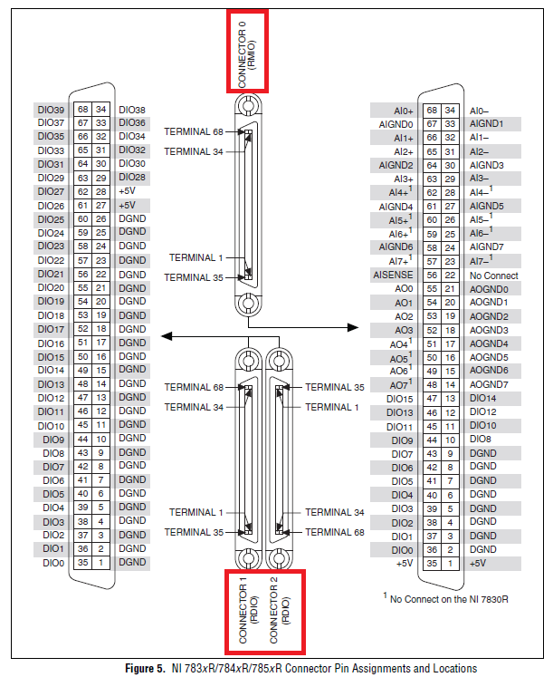

2nd part, we plug the 8-bit data into FPGA and we get the wrong result of PCLK. Even we only plug 1 bit (which is labeled as DIO1 in program) data, the PCLK is disturbed and we can't find why. The connector setup is attached as connector.jpg.
We have tried to make the 2 digital signals far apart but still fail. We have tried to change the cables connected between SCB68 and FPGA from SHC68-68-RDIO to SHC68-68-RMIO cable because we think it may have a better shielding. We have a better result but still wrong.

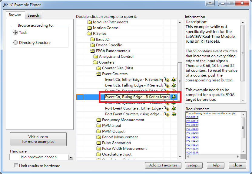

For your first question, I suggest you to run the LabVIEW shipping example to make sure there's nothing going wrong in your coding.
Yor can refer to the folliowing example to implement a custom rising edge counter.
Modify it to fit your application.
Try to test your result with this code.

Thanks for your response. I have also read the articles about the impendance match when we are in MHz range. The result is correct when I input CPLK alone. If I have 2 signal inputs (CPLK and 1-bit data), I will get wrong result.
The code I have modified is as following:
PCLK is 36 MHz. It means if I input 8000 to "loop_num" and I will get 3600 (+ -1) from "16 bit Count" with 80 MHz clock. The strange part is that If I only input PCLK alone, I will have the right result. If I have 2 signal inputs (CPLK and 1-bit data) simultaneously, I will get wrong.
I also tried to change the cable from SHC68-68-RDIO to SHC68-68-RMIO and I have a better result. I am wondering that if there is any suitable cable that I can use for MHz signals.

When it comes to cable, I think the only difference between RMIO and the RDIO is the analog part.
http://digital.ni.com/public.nsf/allkb/2873867ECCF3790B862573B40059ED2A
RMIO fits for both analog and digital signal while RDIO fits only for digital.
It depends on which IO you select then the cable shouldn't be changed.
Check the following image to better understand what I mean.
If you connect the RMIO cable to the RDIO connector, you will get the wrong measurment, vice versa.
