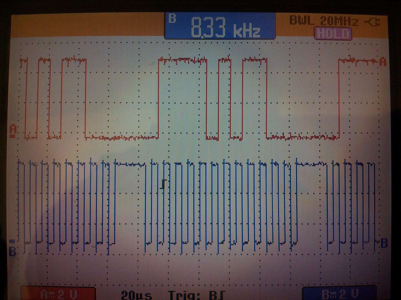

Hello everybody,
I'm also trying to connect on SSI device, but I have little problem with sync (I suppose). SSI is a bit different, it doesn't use CSn signal, it's just Clock and Data (this one). Device is connected through 2 IC LTC485, one "translates" simple clock signal what I'm generating on P0.0, second translates data from SSI to Logic Low and Logic High and then I'm reading it on P0.1. Device is Absolute Encoder with 12 bit precision, that means, I suppose, 12 data bits (Datasheet of encoder). I'm using LabWindows/CVI and PCIe-6351.
What I have done so far :
-I have P0.0 for generating clock signal, it is 28 samples pattern clocked at 200kHz with sample clock, and it looks like this - 1 1 1 0 1 0 1 0 1 0 1 0 1 0 1 0 1 0 1 0 1 0 1 0 1 0 1 0, I checked the signal on oscilloscope and it looked just fine, frequency was exactly 100kHz, monoflop time was over 20 micro seconds.
-From P0.0 leads signal to transmitting IC and then to encoder, I also physically wire this signal to PFI8.
-On P0.1 I'm reading signal returned from encoder, it also uses sample clock, but as timing source i used PFI8, so it should match the CLK signal. Then I have registered EveryNSamplesEvent, as number to samples to read, I have selected 12, because of 12 data bits, but I'm not sure if is this right.
-In EveryNSamplesEvent, i use DAQmxReadDigitalU8, I read 12 samples and calculate decimal number. From image of SSI I'm suspecting MSB on first position and LSB on last position, but maybe I got it wrong. ipow(x,y) is function for integer based Power(x^y).
result = 0;
result += ipow(gData[0],11);
result += ipow(gData[1],10);
result += ipow(gData[2],9);
result += ipow(gData[3],8);
result += ipow(gData[4],7);
result += ipow(gData[5],6);
result += ipow(gData[6],5);
result += ipow(gData[7],4);
result += ipow(gData[8],3);
result += ipow(gData[9],2);
result += ipow(gData[10],1);
result += ipow(gData[11],0);
 I hope this description is enough, if it is not, just tell me, I can clarify or add aditional info.
Now what's wrong:
I'm able to get back data from encoder, but they are evidentely wrong. For instance, if I start my tasks(P0.0 for clock and P0.1 for data input) I get an number from encoder (let's say 2500 for instance), then I stop my tasks and start them again, without even touching the encoder, now it's saying 450 for example. Another thing is that output curve should be linear for one revolution (0-4096), but it is not even close to that, this is what my output curve looks like for 1 revolution (taken when reving was made by my hand, in cca 2 sec interval, that means nothing really accurate, but still should be +/- linear 😞
This is everything what I think is relevant right now, if you need any more description, just ask.
Thank anybody who could help me.
Message 15 of 20
(5,294 Views)

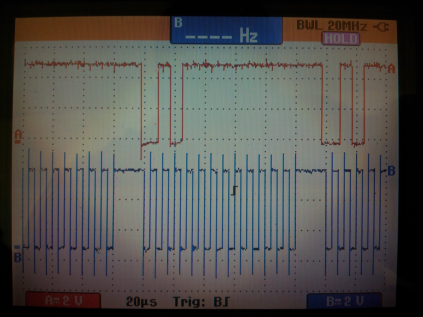

Thank you John for reply.
Anyway I changed number of samples on digital input to 13 and sample off first bit. Now I'm able to get to the max (4096) but it still behaves very odd. I've made sample curve again (same conditions as before - 1 revolution with my hand in cca 2 sec interval). Also it still doesn't keep it's position (983 -> 1415 -> 2755 (this time these are real numbers what I get in ON-OFF cycle)) without moving with shaft. I also slightly changed output pattern, now it has 30 samples like this - 1 1 1 1 0 1 0 1 0 1 0 1 0 1 0 1 0 1 0 1 0 1 0 1 0 1 0 1 0 1 so it matches 13 falling edges per cycle.
To answer and clarify your questions :
-My digital output task is configured on risig edge
-My digital input task is configured on falling edge
I've also made oscilloscope pictures of clock and data signal, don't know if that could help, but maybe it can, this is from yesterday, when sampling 12 bits and using 28 samples pattern mentioned in my
first post :
And this one is with "improvements" mentioned in this post :
//Edit: I also take picture of signal, when I get indicated position 4089 (that was as much as I was posible to get to the max value of 4096 with my hand) and I think that the signal is a bit "messed up" (probably reversed, it should be from MSB to LSB, but it seems LSB to MSB for me(but I may be wrong)) :
I appreciate you help John, thank you.
Filip Sikora
Message 17 of 20
(5,275 Views)
Update : It's working well right now. I've made two stupid mistakes, first I didn't realize that output of the encoder was in gray's code, not in binary code and second, I've shifted + and - wires on Clock and Data signals 😕 I'm really sorry for wasting your time.
Filip Sikora
Message 18 of 20
(5,259 Views)
