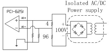

			05-20-2013 08:40 PM
Hi, Lynn.
I think I am a little bit confused about "you will need an isolated input module because you cannot determine the instantaneous voltage between the DAQ input and the DAQ ground."
Let's look at example 1. As shown in figure1, if I isolate the ground of the DC voltage source by using an isolated AC/DC power supply and connect the DAQ and the signal following the NI suggestion about differential measurement of a floating signal, then I think the voltage between the DAQ input and the DAQ ground is specific, that is ±V1/2.
Is that right? Can it work?
Thanks a lot!

			05-21-2013 07:15 AM
I just posted to your other thread.
Similarly to what I said in that thread, you could ground the junction of the 4 and 96 ohm resistors and use a single-ended input.
Will you be making both voltage and current measurements?
Please tell us the whole story and keep it all in one thread.
Lynn
