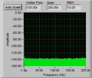

I think this number (100 uV) is the peak time domain signal correct? If you connect your device to a 50 Ohm terminator, you should get what specifications are saying. Since you are looking at a time domain data, you will see the DC + AC. Only DC is 100 uV  + some % (link for details).
This means that the value you are seeing is normal. Now, the value of 3.4 uV is first AC and second for 50kS/s. Take a look at the spectrum when connected to a 50 Terminator
(notice the RBW is not set to 1, so the noise floor does not go all the way down).
What is exactly what you are trying to accomplish that this "noise" is important?
