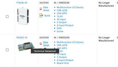

Bare OEM board from exlosed DAQ
I need to replace a discontinued USB 6218 OEM Board (196203-01). However I can not find one online.
I can find an enclosure board USB 6218 (part 779678-01). Can I buy this, and easily remove the enclosure to get the bare board to replace my current one?
I suppose my question is whether the enclosed board has the same connections available, or is it hard wired to the connections protruding from the enclosure.
My apologies if I've used the wrong terminology, I am but a simple chemist.

Try submitting a request to Extend Test, they'll help you find it!  https://extendtest.co/pages/request-part
The OEM version of the board has slightly different connectors, so taking apart a normal USB-6218 won't be the same.
