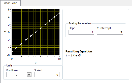

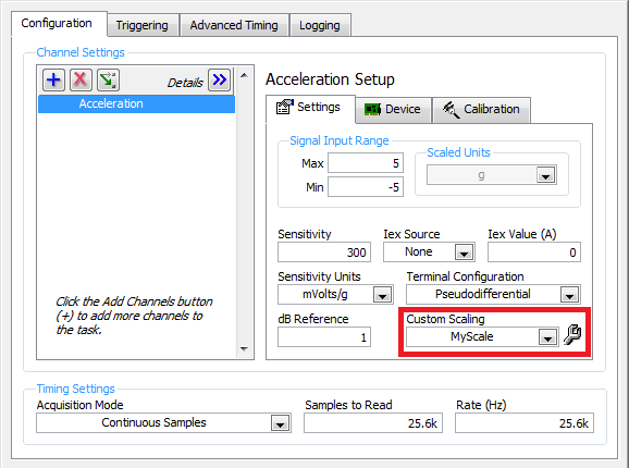

In this case you're going to have to use a custom scale. In MAX, right click on  Scales  » create new  »  NI-DAQmx Scale  »  Linear.  For your scale, the pre-scaled units should be g and set your scaled units to be g. Your slope should be 1, and the y-intercept should be -5. This will shift your scale down by 1.5 V (5g).
In your acceleration task, select your scale under Custom Scaling.
This should sort you out.

Hi Sean,
Thank you so much for the detailed information!
I modified my test using customized scale as you suggested(I totally agree with your calculation). Then I used this test to measure two known signals:
1) cDAQMod6_ai0: 1.8V
2) cDAQMod5_ai3: 1.5V
My accelerometer's output range is 0-3V, with 1.5V at 0g and 300mV sensitivity, so I expected to see a 1g signal on Mod6 channel 0 and a 0g signal on Mod5 channel 3.
The results shows a 450mg acceleration on Mod6 channel 0 and a -450mg signal on Mod5 channel 3. I attached a screenshot with this post, along with my modified SignalExpress project.
I have no clue what went wrong...my NI9234 cards are newly purchased last year. Shall I calibrate the cards? I did notice that in your last post, you have a "Calibration" option on your channel setup page which I don't have. I'm using SignalExpress2009 with Sound and Vibration Suite by the way.
Thank you again for your time!
P.S. So when configuring a channel, for the "Signal Input Range", I should enter the min and max value of my input signal in whatever unit stated in "Scaled Units" block, am I correct here?

Hey,
So if I understand this correctly you applied 1.8 V to the 9234 and you verified that the 9234 is in fact reading 1.8 V in the Test Panel? If this is the case, then there's a problem with the way you're applying your scale. Using your SE project and my scale I applied 1.8 V and read 1 g,  as expected. I attached my scale (just remove the .txt extension) so that you can import it into MAX (File -> Import).
Best of luck.
