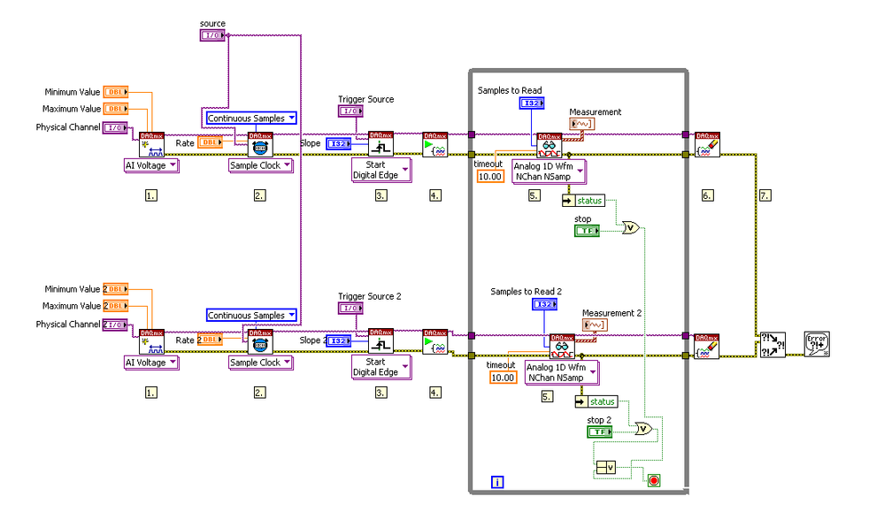

Dear Martin.D
To effectively measure and monitor the position of the encoders, use the DAQmx functions. And use a digital trigger with the source as the encoder channel that starts recording data as soon as the encoder is initialised. Look at the Cont Acq & chart samples Int-Clk-Dig Start VI in the examples or from NI.com examples and use this for your two lines. Set the sample clock for both lines as the same so that both are synchronised. The VI is an adaptation on the example using the two lines. Set your relevant sources and what outputs you desire. Please let me know how you get on with this.

Hi David:
I want to capture the position of multi-axises at the same time at the rising edge of the trigger sigals(the signals of all triggers are the same).How can I modify my procedure according to your advise?How should I configure the
vector space?I have ask some engineers in Shanghai,but until now ,the question is not reslove.

Hi xiaofengliu
Thanks for your quick reply. Simply conenct both trigger sources to each other in the VI. As for the vector space, what do you mean by this? You should not need to configure this. Also your attached VI does not work. Are you using the DAQmx VI's?
Many thanks for using the NI forums and I look forward to your reply.
