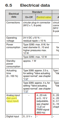

Thanks for this info. I already run the valve by using two power supplies: 24V and 0-10V to control the opening area.
It seems to me that the DIP switch set to Set-point value input 0...10 V by default.
To control it by LabView, I think I need a module generating voltage instead of using adjustable power supply like I did to implement the electrical connection shown in the attached table. My questions is which model ("c-series card") in specific I could use?

OK.
I used NI 9269, and it perfectly works. Now, how can I adjust the opening area (control the valve) according to a temperature measurement?
