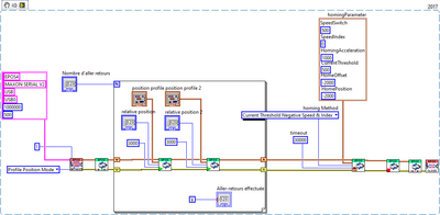

Hello all 🙂
I'm continuing on the path of controlling my motor,

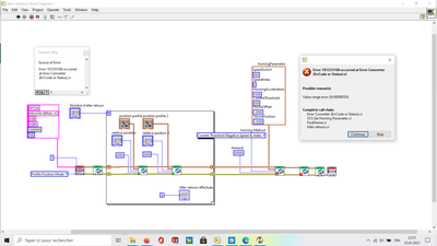

And I'm (a bit) stuck with the homing mode. I think I'll go crazy if I still see this "Value range error (0x06090030)" 🙂
Here is a snippet for those who wants to get an idea :
I'm using the Initialize.vi / EnableAxis.vi / MoveToRelativePosition.vi / MoveToRelativePosition.vi (two times so I can make a way and back)
Then, the famous FindHome.vi (the whole thing works without this one).
Then StopAxis.vi / DisableAxis.vi / Close.vi
Here is a print screen of the error.

This means that the value of at least one parameter for the homing is out of range.
Extract from maxon's documentation :
  • HomingAcceleration : Acceleration for homing profile
  • SpeedSwitch : Speed during search for switch
  • SpeedIndex : Speed during search for index signal
  • HomeOffset : Home offset after homing
  • CurrentThreshold : Current threshold for homing methods −1, −2, −3, and −4
  • HomePosition : Used to assign the present position as homing position
Have a look at SpeedIndex which is set to 0.
(4,429 Views)

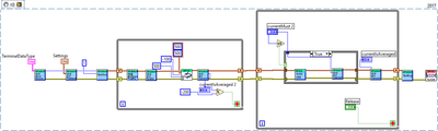

Hi everybody,
I'm continuing the adventure on my small project,
Thanks to JB I was able to manage the homing mode.
Still working on the current mode :
I'm approaching my sample while controlling the speed because if it's already in current mode it my system comes "bumping" the sample with full acceleration. So first slow speed until the needed current is more than 200mA and then current mode to push my sample.
Here is a snippet for anybody interested :
My next problem is that the control in current mode (open loop) is not precise because of the frictions of the system. And second once I'm in contact with the sample I can press (put more torque) to increase the weight, but cannot come back to 0 (the motor doesn't know that gravity exists).
So I'm waiting for a load cell sensor to close my current control loop.
That's why my question is :
Is it possible for me to make a PID current control closed loop without using a special DAQ device for LABview ?
I'll have my S load cell sensor, linked to an amplifier (0-10V output), and I can link its analog output to an analog input on the EPOS4.
(4,375 Views)
