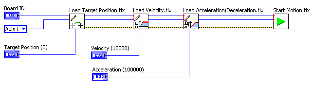

I think a very good fit for your application is the PCI-7332 motion controller. This device is supported by the NI-Motion driver, that provides interactive configuration in MAX, an easy to use API and all the synchronisation and safety features, that you need for your application.
This is how a simple linear move looks like in LabVIEW:
The 7332 supports the step/direction interface required by your motor drive, so this would be a good fit. You can start and stop multiple axes simultaneously and the 7332 monitors limit switches onboard and if you equip your motors with quadrature encoders, the board can detect motor stalls, which might be useful to avoid tilting of your mechanics, if one of your motors stalls or looses steps for some reason.
Adding quadrature encoders would be also very useful to synchronize the position information with the calibration measurement. With an encoder connected, the 7332 can generate digital pulses at certain positions (breakpoint generation), that can be used to trigger a measurement on a data acquisition board. If you are using an NI DAQ board, you even can route the signals internally through the RTSI lines from one board to the other one, reducing external cabling.
Quadrature encoders are highly recommended for your application, but if this is not applicable, there are alternative approaches that we could discuss.
