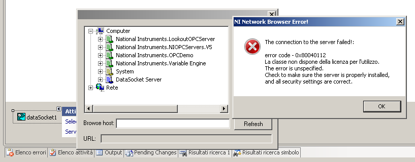

Thank you FatBoyMonchi for your answer.
This is the error I recieve:
I recive this error when I try to browse the OPC from the datasocket browser.
I get this error also when I try to connect to OPC server through OPCNetAPI.
There is something wrong? I suppose I can connect in both ways.
Thank you.

Hi Alex,
thank you for the screenshot.
In this kind of evaluation programs, you have limited time (2 hours a time) in wich programs works right: after 2 hours from the beginning the program stops working.
If you reboot the machine you'd see the program working right again for two hours.
In these two hours everything must be good, so if rebooting the machine, the OPC Server doesn't work right, maybe there's some trouble...I think in this case you can try to reinstall to see if it fixes the problem.
FBM
