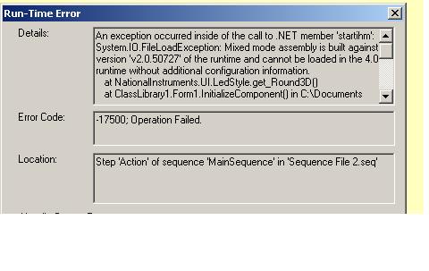

how to use a measurement studio 8.5(framework 2.0) dll, called by teststand 2012 (framework 4.0),(i can't add an app.config to Teststand??) :
An exception occurred inside of the call to .NET member 'startihm':
System.IO.FileLoadException: Mixed mode assembly is built against version 'v2.0.50727' of the runtime and cannot be loaded in the 4.0 runtime without additional configuration information.
