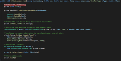

I am having trouble generating a waveform for AO0 (sine wave) and AO1 (cosine wave) respectively.
I can generate any waveform on a single channel, but generating waveforms to multiple channels eludes me.
Code:
I tried using AnalogMultiChannelWriter but I couldn't get the multidimensional double[,] set up correctly..
Anyone have advice for how to proceed? Is there an NI example? I couldn't find one in my local ...\National Instruments\NI-DAQ\Examples folder.
Thanks in advance,
Jon

You need to put both channels in the same task and use the N-Channel writer instead of a single channel.

I'm not finding the "N-Channel writer"...
I tried using "NationalIstruments.DAQmx.AnalogMultiChannelWriter" but this proved not to be so intuitive.
Which class are you referring to?
(3,580 Views)
Yeah, that one, NationalInstruments.DAQmx.AnalogMultiChannelWriter

Does anyone have an example of how to set up the multidimensional waveform for the 'AnalogMultiChannelWriter' class method 'WriteMultiSample'?

I figured it out. My multidimensional array was being populated in the wrong order.
This works:
