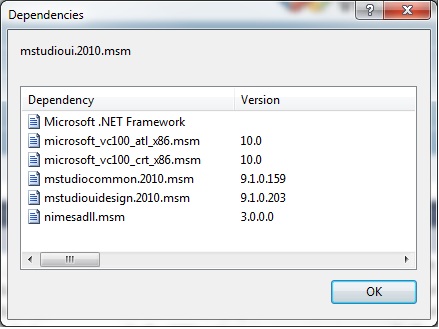

  • mstudioui.2010.msm *right-click->properties->dependencies:
    1. MS .Net Framework
    2. microsoft_vc100_atl_x86.msm (Version 10.0 , no warning displayed!)
    3. microsoft_vc100_crt_x86.msm (Version 10.0 , no warning displayed!)
    4. mstudiocommon.2010.msm (Version 9.1.0.159)
    5. mstudiouidesign.2010.msm (Version 9.1.0.203)
    6. nimesadll.msm
mstudioui.2010.msm

After replacing the MS_VC100_CRT_x86/64.MSMs in my GAC folder (as per NI tech. Supp. suggestion) I still get all those errors. although now the Installer builder complains about not having MS_VC100_CRT_x86/64.MSM.DF495 ... (The ones with the signature that were already there!):
It seems that mstudioui.2010.msm is the only one that is looking for Microsoft_VC100_CRT....DF495.....
I tried adding the "Microsoft_VC100_CRT....DF495....."to the installer project but still no luck 😞

Here is more detail about the dlls and msm used in my app.
As a test app., I created a new visual studio VC# project for .Net 4.
Added 3 LEDs to the main form.
Added an installer project to the solution.
Added the main output of the test project to the installer project and then there are several NI .msm's and .dll's added to the detected dependencies folder.
their list exactly equals to what I mentioned in my original post, only this one has differed:
  1. MStudioUICommon.2010.3DAB91FED19D4807AC84E31805C87270
    1. Microsot .NET Framework
    3. Microsoft_VC100_CRT_x86.DF495DFD_79F6_34DF_BB1E_E58DB5BDCF2C
    4. mstudiocommon.2010.msm (Ver 9.1.0.159)
    5. mstudiouidesign.2010.msm 9.1.0.203
    6. nimesadll.msm
I think somehow at some point, all the NI .msm/dlls got updated on my PC except this one (Maybe my internet connection was bad, maybe NI did not update the microsoft merge module signature in the file in that update and then I did not update my NI again, whatever,....). Therefore, he is still looking for the old Microsoft_VC100_CRT module.
If you can, please provide me with a MStudioUICommon.2010.msm that seeks the same Microsoft_VC100_CRT module as the rest of the NI modules on my PC.
So that I can try and see if replacing this will fix my problem or not!
