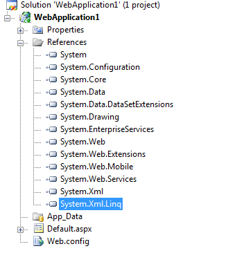

Do you have any: <ni: elements in your aspx page? If i Create a new project with Measurement Studio installed by default I have no references:
Richard S -- National Instruments -- (former) Applications Engineer -- Data Acquisition with TestStand

* Created new asp.net project, save all, archived (before dir)
* Added button control, hit save, a few seconds later, NI was added to web.config - automagically (after dir
Message Edited by Manlon on 03-16-2010 01:25 PM
