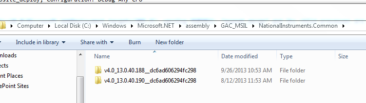

Some additional information...after reinstalling MS2013 and all .NET references, I notice that there are two NationalInstruments.Common.dll libraries in the GAC.  Maybe there is a conflict when Visual Studio attempts to package the web application?

There should be one. Do you have two version of visual studio installed for two different versions of measurement studio. It would say Measurement Studio 20xx for Visual Studio 20xx, and the place to check is control panel>>add and remove software>>right click national instruments software.
Can you just also try moving one of them (.188 version) from GAC to another folder and run again. Let me know how it goes.

Removing the .188 version from the GAC worked.  It appears that some of the other packages are referencing the older library.  I also tried manually referencing the older version (.188) in the solution and adjusting the Web.config accordingly.  This method also solved the problem.  Thanks for your help!
