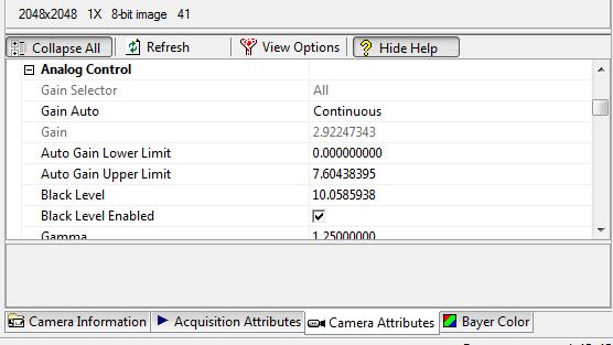

I would like to save and load camera attributes for my PointGrey GrassHopper3 USB3 camera.  Should be simple, MAX has the functionality and it also appears you can use IMAQdx Read Attributes and IMAQdx Write Attributes, all save as *.icd file.
What is happening in practice is that MAX and IMAQdx Write Attributes only write a small subset of all the attributes. *.icd file copied below, the attributes have emotions!
I can see all the attributes in MAX but they are not saved to file by MAX.  If I powercycle the camera I lose the settings.
How do I save and load the cameras settings without writing my own code to Read a File and Write to each attribute via a Property Node?

Hi Tom, I updated to MAX 15.0 but the same problem persists.
I've also noticed that MAX will warn of out of range parameters when saving, the parameter name is displayed e.g. Attribute Value is out of range  "CameraAttributes::AcquisitionControl:AcquisitionFrameRate"
when you open the *.icd file the parameter is not there, this applies if the parameter is within range or out of range.
I would imagine that MAX reads attribute names and values from the camera.  I've used the example VI "Grab and Attributes Setup.vi" this VI appears to take the attributes from the camera, but again if you use IMAQdx Write Attributes.vi, it writes the same short list of attributes as MAX.
I'm starting to wonder if only the variables listed in the *.icd file are available to change.  However, I can edit "Gain" on the fly during the Grab and watch the image get darker/lighter, but Gain is not written to the *.icd file.  This suggests all the visible attributes are available but not written to file for some reason.

For GenICam cameras (GigE, USB3), the camera's XML file specifies which attributes can/should be persisted. You can find this file on disk at C:\Users\Public\Documents\National Instruments\NI-IMAQdx\Data\XML.
If you search the word "Streamable" you will find things like this:
<Enumeration Name="GainAuto" NameSpace="Standard">
<ToolTip>Gain Auto is the 'automatic' counterpart of the manual gain feature.</ToolTip>
<Description>The gain auto function automatically adjusts the Auto Gain Raw parameter value within set limits, until a target average gray value for the pixel data from Auto Function AOI1 is reached.</Description>
<DisplayName>Gain Auto</DisplayName>
<pIsImplemented>N100</pIsImplemented>
<pIsAvailable>N101</pIsAvailable>
<Streamable>Yes</Streamable>
IMAQdx respects the camera's list of attributes that are to be persisted. If it's not in the icd file, then the camera vendor didn't mark it as streamable.
If you don't want to write all the other attributes to the camera each time, you should explore whether or not the camera has the user sets feature. Many cameras will allow you to save different configurations to non-volatile memory so that they'll power on with these settings by default.
