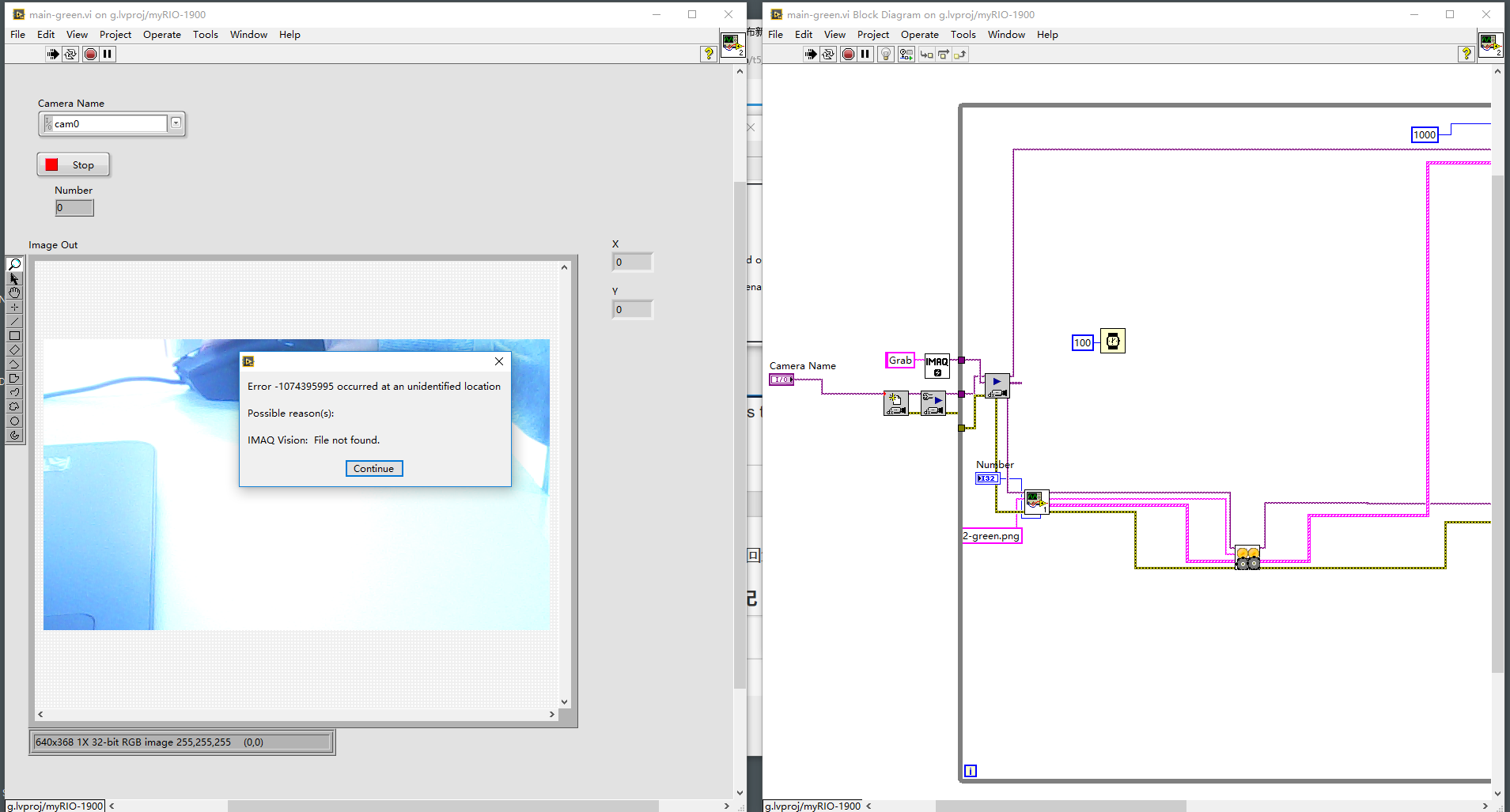

When i use labview 2014 creating a vi about machine vision,it can run.However,when i add this vi in to myrio project,it cannot run.The error
this is the vi:

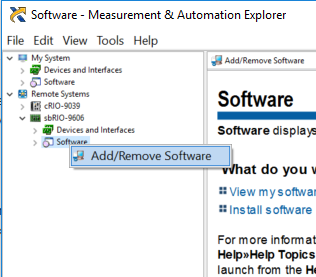

It looks like you probably haven't deployed "Vision Features" software to your myRIO. When selecing software to install from the RT software wizard, you need to be sure to select "Vision Features" which will deploy the correct libraries to your target (see screen shots below).
