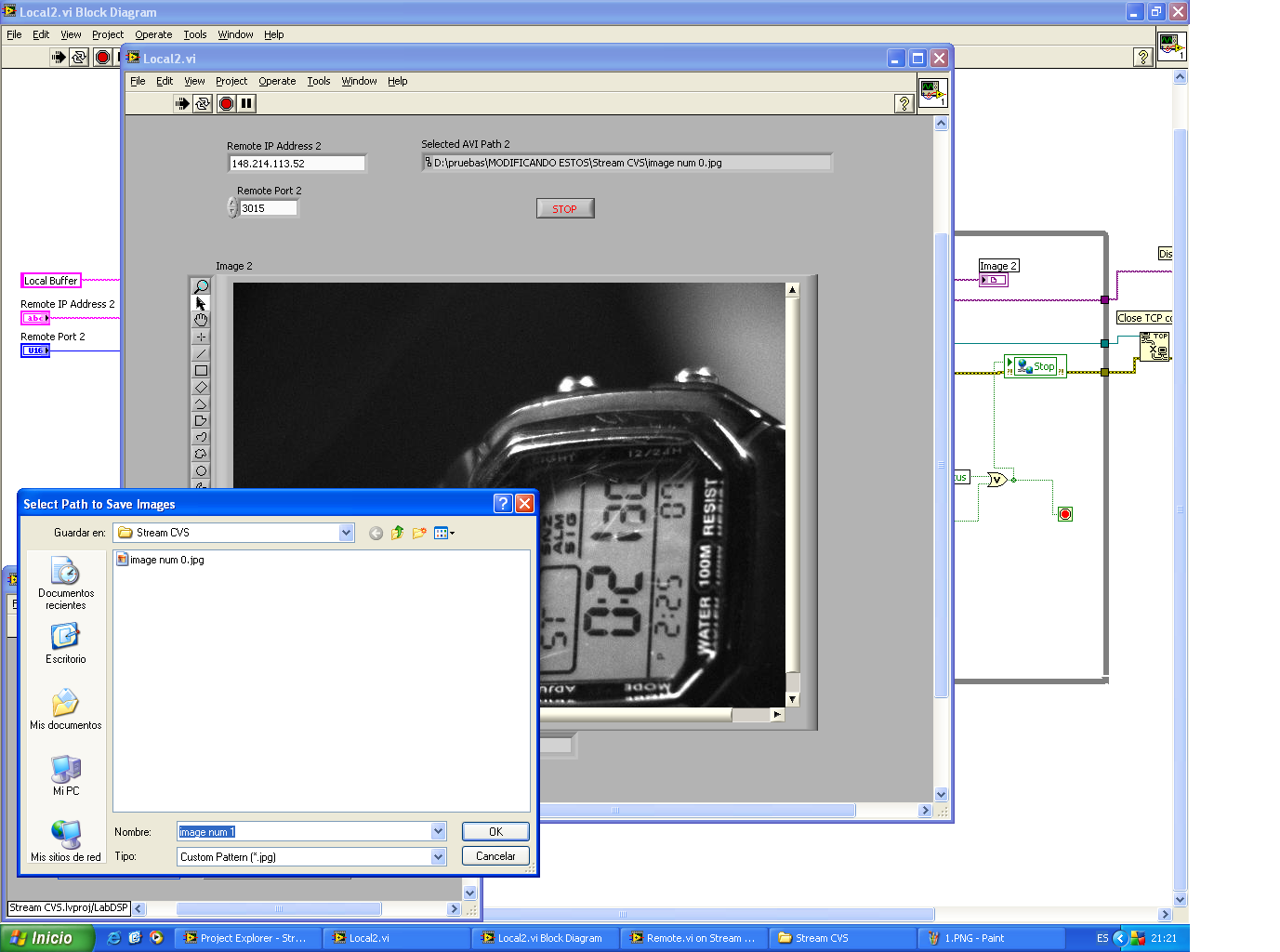

I've tried this before watch your comments and I got these results:
I modified the Local.vi (PC) like this:
and there appears a windows asking me about the location of the image, it changes automatically the name of the next image (maybe I should allocate the FILE DIALOG VI outside the For Loop):
The images are "saved" on the folder I choose, but when I stop running VIs, any images are not availables I don't know why:
That's the idea of what I want to do, even so I want to prove your suggestion Mr. Ammons. Even so, I'd like to know your answer at my questions 1 and 2 and your opinion about these last images.

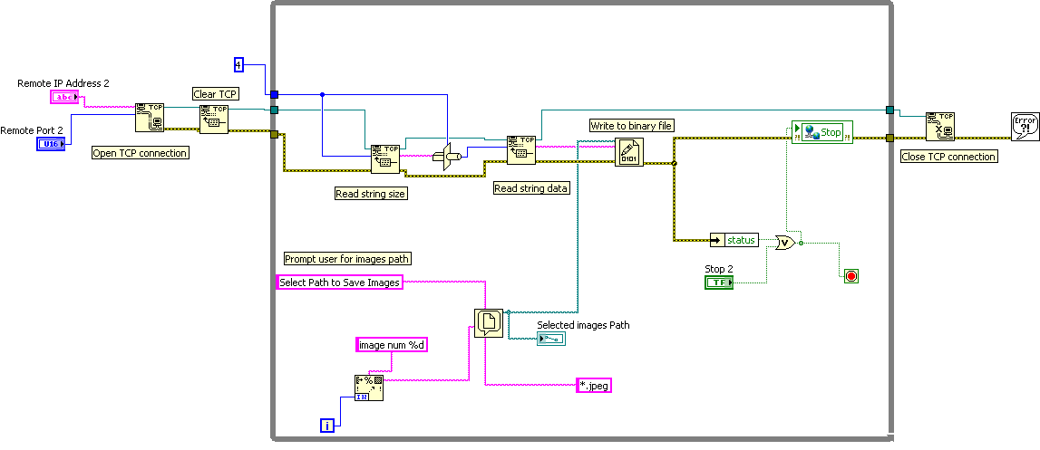

Ok, thanks for your comments.
I've changed the Local.vi (PC) to not unflatten the string. I've tried to save directly to a file and the images are being saved, but I cannot open them, I get a Preview not available. Am I making a mistake with the File Dialog.vi? I'm writing in pattern all files *.jpeg, should not write this? Where can be the problem?
Here is the PC vi:
and here is an image of how the images are being saved:
 Thanks for all your help and comments.

On Write to binary file, set the Header boolean input to false.  You don't want to write the header info, just the string.
