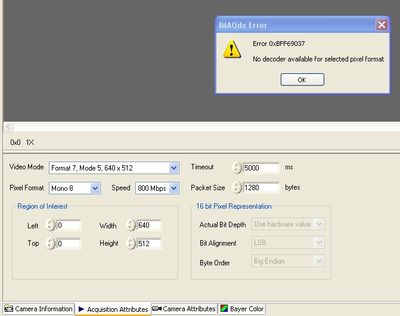

I realize this thread is probably dead and buried but I am experiencing something very similar.  I have a custom 1394 IR camera that outputs 8 bit grayscale (enumerates as "Mono 8").  We have been building this camera for about 8 years and have been using Legacy 1394 IMAQ drivers for testing.  Since NI has discontinued support we are trying to port our test software to IMAQdX.  IMAQdX recognizes the camera but when you try to acquire/grab using the same settings that worked in legacy it throws up errors saying it doesn't have the specified pixel decoder or there is a out of range attribute.
Has anyone solved this?

Can you show a screenshot of the acquisition tab in MAX?
Eric

IMAQdX Settings:
IMAQ 1394 Settings (activily Capturing, same camera as above, only drivers changed)
Bayer settings are set to "None"

I suspect that there is some odd interaction between what the camera says is its supported pixel codings and what it is using, but it is hard to guess without actually seeing what the camera is doing.
Have you tried changing the Bayer tab from "Hardware Default" to "None"? It adjusts how the driver tries to select a decoder and might let you work around the issue.
Eric

Yes, I've already got Bayer Settings set to "None" and have tried "Hardware Defaults" as well. I have a support ticket with NI open, and if we actually figure this out, then I will post the results.
