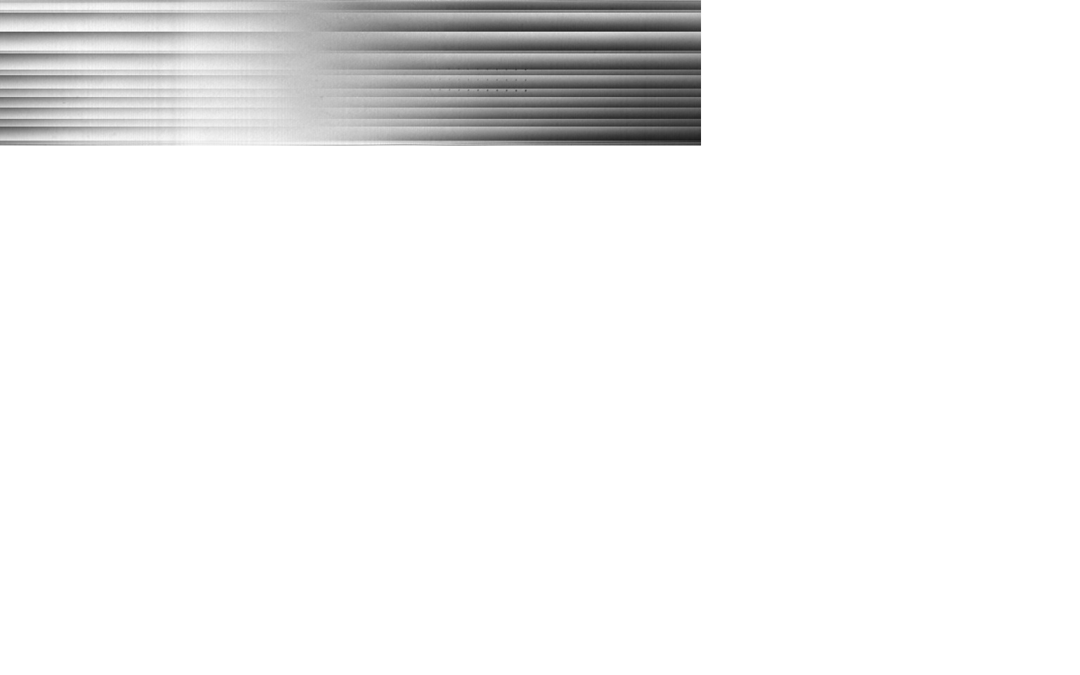

I plan on trying the following strategy with each of the filters you propose.  I started with Andrey's and added some code to it to handle the borders issue.
I first went back to my circular edge detection scheme which provides subpixel resolution for Center (x,y) of the circle.
I think that Andrey's filter is working fine, but I am still not getting where I need to be as I still see discrete horizontal lines in the "unwrapped" image (I am stacking the circle images to form a cylinder and unwrapping the cylinder to form a sheet) rather than a smooth image that I get from ImageJ RigidBody Registration and the custom Python code.
I suspect the problem is with the edge detection itself rather than the subpixel registration.  I will plug in Bruce and Greg's subVIs in next.  I can also try modifying some of the parameters in Andrey's code such as kernel size and filter type but again, now I am suspecting the discontinuity lines may be more of an issue fundamentally related to the IMAQ algorithm.

Don,
If your final goal is to unwrap the circle into a strip, I would start with that first.  I would find the center of the circle in each image, then use IMAQ Unwrap to get a strip.  I would include a few pixels of thickness to make sure you get the details you need.  You could analyze the strip to see if you hit the center (check for sin and cos components) and iterate.  You could also equalize each strip if needed.  Then you could combine the strips into a 3D sheet several pixels thick.  I'm not sure how you would convert that to a 2D sheet, but there must be some rule for that.
I think doing subpixel manipulations on the original image is just adding blur to your final results, since you have to do more interpolations for the unwrap anyway.
Bruce

I have applied the linear curve fit to the measured shifts from the circular edge detection routine (source minus reference center x,y position) to get slope and intercept and compute shifts in another loop iteration from Y = mx + b in order to hopefully get a smoother unwrapped image when applying the shifting. Reference image is an excellent quality image from the center of the stack.  I use the middle 60% of the image stack for the linear curve fit slope and intercept.   I do this in both the X and Y directions.   As I mentioned earlier, the subpixel resolution of the center coordinates of the circles determined from the circular edge detection routine is helpful here because it should provide a better fit.   However, as it turns out, the subpixel resolution of the circular edge detection routine is so good, I am not even sure I need curve fitting step (the best linear fit and the measured shifts from circular edge detection center outputs lie almost on top of each other).
However, I still run into the same problems related to the horizontal banding in the unwrapped image.  I did try reversing the shift direction for both X and Y, and that made things worse.  I tried applying each of the Ammons, Andrey, and GregS additional subpixel shifting on the back end for the actual shifting after computing the shifts from the linear fit, but I still get the banding.   Bruce, basically, my procedure is what you have described in your last post.  I am only showing one unwrapped image as an example but there are a whole number of them separated by the voxel dimension of the CT scan.  The edge detection routine appears to work really well.  I am not sure why this is not working.  Have to stare at this a little longer.   All of the help has been greatly appreciated.

Don,
Any way you can post a small set of images that I could play with?  I really don't understand where the banding is coming from.  I suspect the interpolation during the unwrap is the issue.  Is the image with banding a single layer of the 3D slab after unwrapping?  If you look at a single strip, is there any sinusoidal variation?
Bruce
