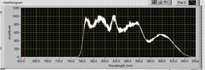

Also, my end goal is to produce an interference signal shown below.
Hence, my enquiries are these:
1. Did I misunderstand about how to implement imgGrab() and imgSessionSaveBufferEx() ?
2. Is there any advice on how can I achieve my goal?
