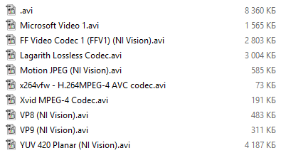

Actual Results:
  1. In a Results table:
    1. Codec column contains filtered codec names used for file creation;
    2. Avg Write Time (ms) column contains frame write times expressed in seconds;
    3. File Size (KB) column contains AVI file sizes expressed in kB (base 10 unit as defined by SI);
  2. If an x264vfw codec is installed in a system, example fails with an error -1074395992 File access denied, because it tries to create a file with a name containing one of restricted characters, namely "/".
    I understand that it's just an example and doesn't account for everything, but it already has name filtering in place and could easily filter all restricted characters.
Fixed version is attached below.
Reported to NI with SR #7811774.
