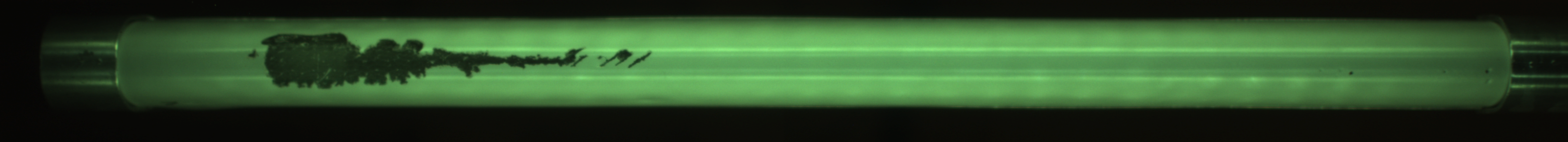

Our mechanical team have built a machine that randomnly erodes the surface of some test specimen.
This is an image of a test specimen captured at the beginning of a test:
As you can see four white lines are present in the image, the lines are caused by reflections from the lamps.
And this is an image of a similar test specimen at the end of a test.
We already have found a satisfying way of measuring the area of the erosion Smiley Happy and it seems to be robust for all possible test specimen colors Smiley Happy
Now they have decided that they want the machine to (online) measure the length of the white reflection lines, as the erosion for some materials only causes the surface to become matted.
And does not necessarily give the dark eroded area seen above.
an example of such a use case can be seen below:

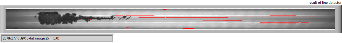

tuning IMAQ Detect Lines
gives me this:
Which is not exactly what I want as I hoped that the lines left of the eroded area would also be included, and that the lines found above and below the highlights would have been excluded, but getting closer.

You can very easily find the very top and the bottom line using an Advanced Edge Find function. From there extract the pixel values form the line profile and you should be able to detect any nonuniform pixel values.
There is a screen shot of the result.

Hi, we have created this reference specimen, that was partially protected (like the red one)
to create an image with a known matted area.
During the test most of our current specimen are not matted first, and I have no other images on my laptop with matting, so it will have to do.
We do not expect well defined vertical matting areas. 😉
Here the images are attached
245.png is before the matting
4160 is after.

I have not tried Advanced Edge Find function
But the ones I tried would normally have false positives, as it finds edges using derivatives, and other derivatives may be present than the ones caused by reflections 😕
I have another method for finding the reflection lines, and the solution that seems to be working for me is to use my method for finding the lines, combined with your idea of sampling the line as a 1D signal analysis.
my colleague just told me that he have created a non-kausal signal reconstruction filter that can determine the reflection lines robustly in the 1D data.
Hence I have accepted you'r answer to the question Smiley Very Happy
The method I found to the line detection was as follows (as the reflection line is the highlights, it always contains the points with the nhighest illumination):
sample n coloumns (n <= Width) with "get rowcol vi"
create a black image, copy of same size as input
for each coloumn
    pick the 5% of the pixels with the largest intensity. (luma channel)
    copy pixels to black image
the result is an image that contains the reflection lines for a coloumn, if the reflection is present in that coloumn, and otherwise some random points.
The result is that the probabillity of a false positive is greatly reduced, as edges that occurs near shadows or erosions are suppressed before the line detection 😉
