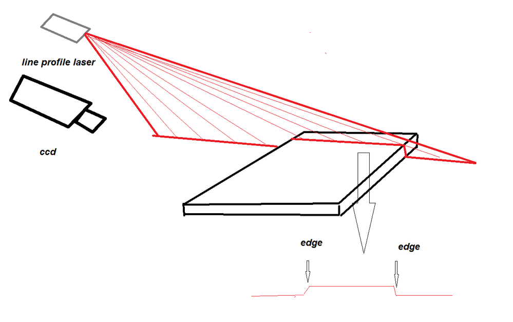

sorry for my first misunderstanding
any way I could suggest 3 method maybe you can create machine vision with combination of them
1 use line profile laser to find edge in one part of your image and try to corp image in front of that line based on conveyor speed
like bellow image schematic
2 in this method we should create small but long lighting device that emit to slab edge and  make edge glowing
using small led array or line profile array  are recommended
the schematic should be some thing like that
3 investigate on slab and convener light abrasion and reflation static   and select light with wavelength that are so far a way in amount for these to subject( some time find such wavelength  in light is impassible but some time work well )
4 use 2 camera and imply 3 stereo vision and photogrametry method  to find slab contour and make data to corp
I hope these data could help you to solve your issue
