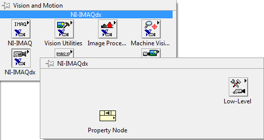

Hi Guys,
I installed LV2011 with VDM 2011, installed imaqdx drivers too and installation was successful. But in functions palette the imaqdx vi's are missing.
Note: I reinstalled the driver twice the time and i also installed Latest driver downloaded from online (VAS_September_2011). Still seems to be not showing up. Please provide me any directions to resolve this issue. (Personnel: Is it a kind of BUG?)..

Hi Guys..
I found this article helped me Smiley Surprised http://digital.ni.com/public.nsf/allkb/A451D3CCBB740716862578FC004DB392. After activation, installed once again the latest driver.
Smiley Happy Problem Solved !!!!!!!!!!!!  Smiley Happy
