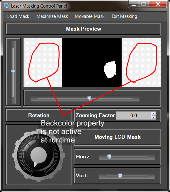

I use IMAQ Vision Development Moule 2010 with VS 2010.  I observed that the backcolor property is not active at runtime although it can be changed at design time.
Is it a bug? I also observed that palette type is not changed  at r untime.
24270i080A69E48951848B
All help is appreciated.

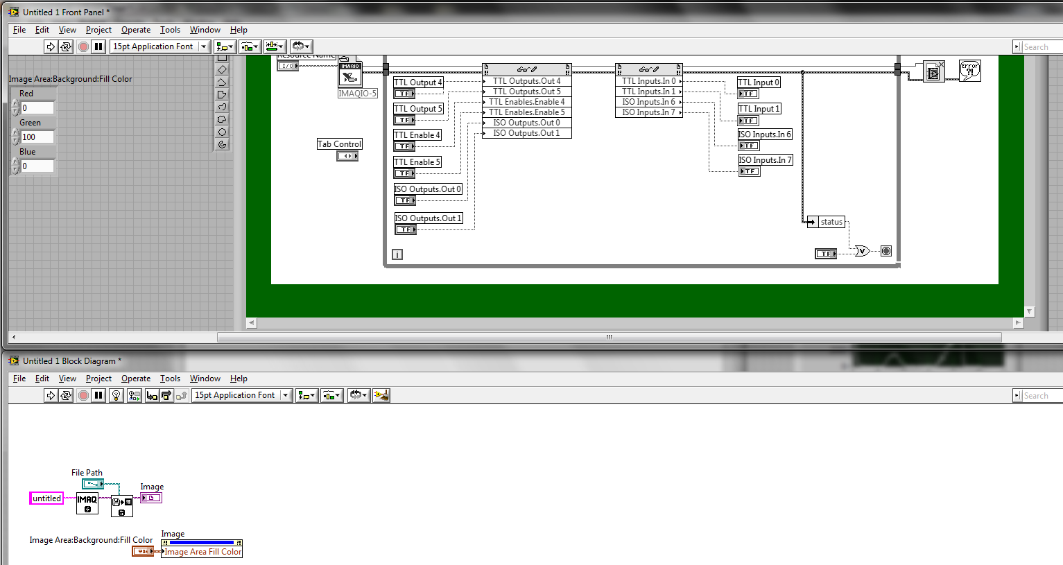

Are you using the correct property node?  I've used the following at it seems to work.
Let me know if you have any additional information.

There is a property called Image Area Fill Style which you need to set to Solid rather than Default.  Then you should be able to change the color during runtime.  If you have it set to Default, it will not allow you to change colors.  Sorry I forgot you were using Visual Studio.  Even though I'm using LabVIEW, you should be able to do the same thing in Visual Studio, just set both these properties.
*Edit: Just a small note, there is no need for me to use an explicitly linked property node here.
Hope this helps!
