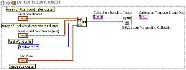

hi gregstoll,
 i need to do point coordinates calibration in labview vi file
Point1   pixel 50,50      real 400,400
Point2   pixel 300,50     real 750,400
Point3   pixel 50,300     real 400,750
Point4   pixel 300,300    real 750,750
 if i have 4 pixels point and real world location means how to apply this value to create calibrate image in labview .. (without vision assistant )
Message 7 of 11
(5,225 Views)
this should work (check out the help for IMAQ Learn Perspective Calibration for more information) :
