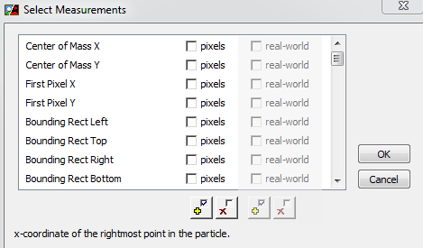

I've checked all over for centre of mass x and y(exactly what I need), but I can't seem to find it.
In Vision Assistant, under the Particle filter(Binary) there're mentions of particle centre of mass x and y, but that's just a filter.
Also is there a way to place bounding rectangles around the blobs(for aesthetic reasons)? I can only think of calipers and overlay.

Hi
You can find these in particle analysis step
Capture.PNGCapture1.PNG.

Ok, this is exactly what I was looking for! Thanks a lot.
I'll start work on the blob tracking routine.
I'll post images and my VI, when I get satisfactory results. This is very useful.
