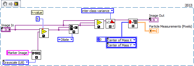

Actually i want to run this algorithm real time,, to find out the peak position from graph ,, i need to generate the position automatically,,, firstly i try to use image processing by  apply threshold followed by edge detection and the find out the center of each  detected part. the drawpack of this procedure is that the obtained images are different and that lead to different threshold values,, so how can i directly find the position from the graph,,, here i attach the image and the graph of the image,,

I suppose there are a handful of different ways to approach locating peaks in an image. What I would go ahead and try first is the H-dome transform, a pretty standard tool for discovering local minimas and maximas. There's a LabVIEW Vision example of it as well: LabVIEW\examples\Vision\2. Functions\Grayscale Processing\Gray Morphological Reconstruction H-Dome Example.vi
The H-dome transform itself ends with the second subtraction. From there you can take it to basic auto-threshold followed by particle center of mass locating. If all your images are the same style like the one you attached, this should work quite well. Give it a try.

Thanks Vekkuli,,
i try this diagram, the result is black image,, may  be i have some mistake,,, so please can you attach the example because its not included in my sofware,,, iam using LV 2009,,

Put some probes along the way, where does it turn black? Note that the resulting image is binary, only values 0 and 1, make sure you have the image display palette chosen as "Binary".

Don't worry about getting your hands on the example, I don't see why you would need it. The steps are essentially the same as in the diagram above. Did you find what the problem was with getting the black image?

Vekkuli
i try that block diagram,,, but the results also is changed continuouslly as i am changing  the raw image,, and to get the desired result i have to add another value,,, in this case my work will be meaning less,,, because i need the results as real time not by post processing,,, i think the better way is to find the contours of each peak from the 3d graph directly without using image processing,,,
