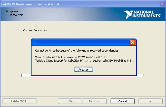

Hi Kristen, thanks for your answer. Of course, I have LabVIEW 2009 and LabVIEW Real-Time module 2009 installed on the PC.
I can see that Smart Camera have installed LabVIEW Real-Time 8.5.1, but when I try to update to LV RT 9.0 (2009):
and I see the review selections:
 Then I click Next and the next error message appears:
 I understand about dependencies (like Windows services), so, I unistalled succesfully Vision Builder AI 3.6.1, but the problem persist with Variable Client Support for LabVIEW 1.4.1, then I tried to update it to Variable Client Support 1.6.0 which is available on the host
but another error message appeared:
 I don't understand this last error, because when I was searching any solution to this problem, I found this page: "Creating Remote Front Panels with a Smart Camera" where I can see they have LabVIEW Real-Time 9.0 and Network Variable Engine 1.4.1 and Variable Client Support for LabVIEW 1.6.0 at the same time. So, I think it means that is possible to update in my case but I don't know if there should to be an specific order to update the software, or should I uninstall Network Variable Engine 1.4.1 and Variable Client Support for LabVIEW RT 1.4.1 to update the Smart Camera to LabVIEW Real-Time 9.0, and then back to install the others programs needed?
Thanks for your help.

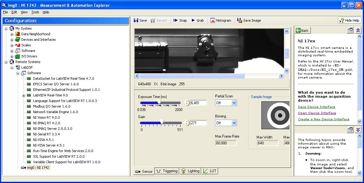

Hi Kristen, thanks for your comments. Guess what? This morning (10-may) I updated the software of the Smart Camera, I chose update everything, I unistalled Vision Builder and Language Support for LabVIEW and everything is up-to-date:
Even so, I can't add the Camera as a Target or Devices because it doesn't appears in the Add Targets and Devices window. I'm feeling a little bit dissapointed about this.
I was watching at this page:Add targets and devices dialog box and I don't have the option of Add device on remote subnet, I guess I need this because I have the Smart Camera connected through ethernet.What do you think about it?
Thank you so much for your help.
Bebin
Impossible is nothing
