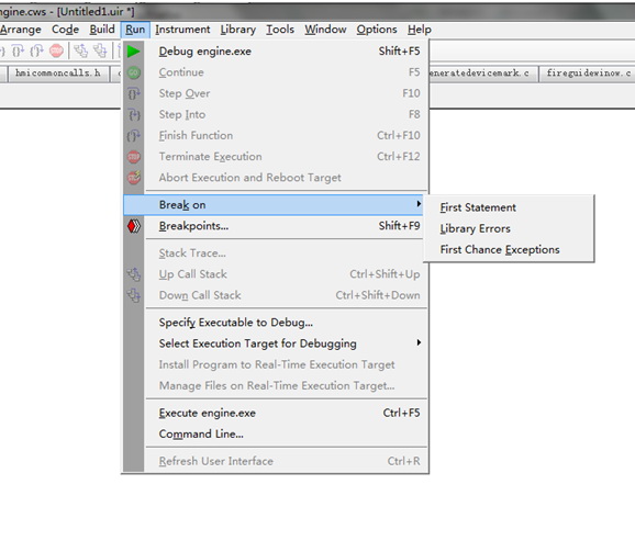

In fact, I want to imitate the menu style of CVI, but this menu style seems not be a submenu, because when moving  the cursor on an item, it popups a panel. So, is there anyway to display the arrow sign?

That means I must add a sub item, and it will popup a specified menu window, it likes the following picture:
But I just want approch this effect:
this shoud be a panel not a sub menu.
David

The 'Create' menu submenus in the UI editor are not panels. They are special menus created for CVI that can display pictures. Unfortunately, you cannot create similar menus in CVI.
If you just want to display the right arrow, you can make an item be a submenu with NewSubMenu. The right arrow will appear, even if you don't give the submenu any items. However, I'm not sure how that would be very useful to you.
