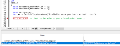

Thank you for suggestion. Just tested with a font which for sure doesn't exist, but GetFontTypefaceName still returns incorrect answer...

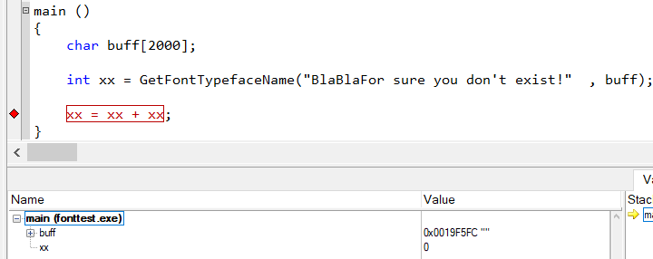

Interesting. I tried a test like that and got 0 as the length and an empty string:
The closest I could easily get to your setup was CVI 2009 with the 2010 RTE. Maybe a bug that was fixed after 8.5. Or it is related to the Win32 API.
