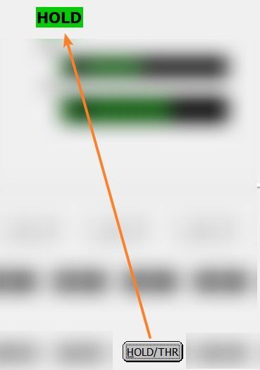

and I finally can't work out the long click problem, I don't know how to use mouse events, here is the problem.
When I click HOLD/THR button, it appears HOLD on the screen,
and when I click HOLD/THR for more than 2 seconds the next time, HOLD disappears from the screen.
Is it
EVENT_LEFT_CLICK_UP or EVENT_LEFT_CLICK
I don't know if I should use them, but won't work.
Thanks in advance!

This is exactly one point where in my opinion you should design the PC program differently from the instrument: you could for example add a toggle on the UI with hold /free meaning.
BTW checking for EVENT_LEFT_CLICK while you are handling EVENT_COMMIT is nonsense Smiley Wink
