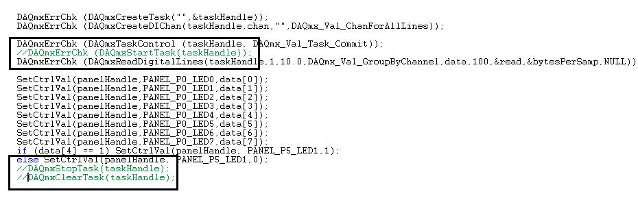

I want to read a Digital channel and then detect changes on the same channel. I can make this operations separately but I want to make it in one program.
this is the first part. It works separately.
DAQmxCreateTask("",&taskHandle);
DAQmxCreateDIChan(taskHandle,chan,"",DAQmx_Val_ChanForAllLines);
DAQmxStartTask(taskHandle);
DAQmxReadDigitalLines(taskHandle,1,10.0,DAQmx_Val_GroupByChannel,data,100,&read,&bytesPerSamp,NULL);
DAQmxStopTask(taskHandle);
DAQmxClearTask(taskHandle);
this is the second part.It works separately.
DAQmxCreateTask("",&gTaskHandle);
DAQmxCreateDIChan(gTaskHandle,chan,"",DAQmx_Val_ChanPerLine);
DAQmxCfgChangeDetectionTiming(gTaskHandle,risingEdgeChan,fallingEdgeChan,DAQmx_Val_ContSamps,1);
DAQmxRegisterSignalEvent(gTaskHandle,DAQmx_Val_ChangeDetectionEvent,DAQmx_Val_SynchronousEventCallbacks,ChangeDetectionCallback,NULL);
DAQmxGetTaskAttribute(gTaskHandle,DAQmx_Task_NumChans,&gNumLines);
for(;i<gNumLines;cachedData[i++]=-1);
DAQmxStartTask(gTaskHandle);
and somewhere is the ChangeDetectionCallback;
Problem is when I perform the first part then the second part doesn't works. No change detection.
Can somebody Help my?

the program doesn't detect any change. In the first task I read Dev1/port0/line0:7 and in the second task I read the same Dev1/port0/line0:7.
I tried to use some Delay() between the tasks but it didn't work.
When I don't use the first part (/*     first part */) then the changedetection is functionaly but I need to know what is on the port when the program starts.

I need to know the init state of my device (ReadDigChan) and then check the operation of my device(ReadDigChan-ChangeDetection). I send you part of my application in attachment. Problem is in the CVICALLBACK CmbfStart. The part in /* */ is responsible for ReadDigChan. Now works the ChangeDetection. But when you delete the /* */ then works only ReadDigChan nothing else.

I’m still investigation the reason why the “Read Change Detection vi” does not work if the “Read Chan vi” is run first in the same CVI code. I have two works around: first if you take your code and comment out the lines: DAQmxErrChk (DAQmxStartTask (taskHandle)), DAQmxStopTask (taskHandle) and DAQmxClearTask (taskHandle); you will be able to read the first value and then detect the changes.  (See picture attach).
Second, since your clock is been controlled by the changes on the lines the only line you won’t be able to read as it is; is the value of the line where the change was detected, but since the value is latch after the change is detected the value is always going to be the inverse of what you read, this will be true in the case that you are detecting changes in rising and falling edges.
I hope it helps

thank you for your help. I took the code out and it works.
