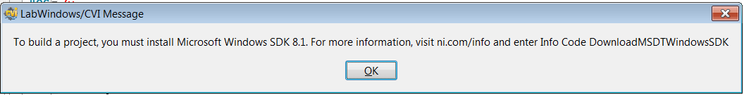

Installed, registered, launched recently worked project, went to build it, and CVI 2015 requires installation of Windows SDK 8.1.  Got following error message popup.
I browsed to ni.com/info, entered the code and was immediately sent to the Microsoft SDK 8.1 page.  No NI information on what to do, how to install, how to link the SDK to CVI.  Tried to download SDK 8.1, and it keeps saying the file is corrupted.  Tried SDK 10.0, which says it supports Win7, downloaded, installed, CVI does not recognize anything, wants SDK 8.1.
I am dead in the water.  Help!

Problem solved, sort of, through the back door, a most undesirable way to complete the installation:
Find and execute this file from the DVD:  D:\Distributions\CVI\Products\MSDTRedistributables_WindowsSDK_81\sdk\sdksetup.exe
This successfully creates the C:\Program Files (x86)\Windows Kits\ folder.
I have no idea why the installed does not do this automatically for my Windows 7 laptops.  I hope that NI fixes this when CVI2015 SP1 is released.
